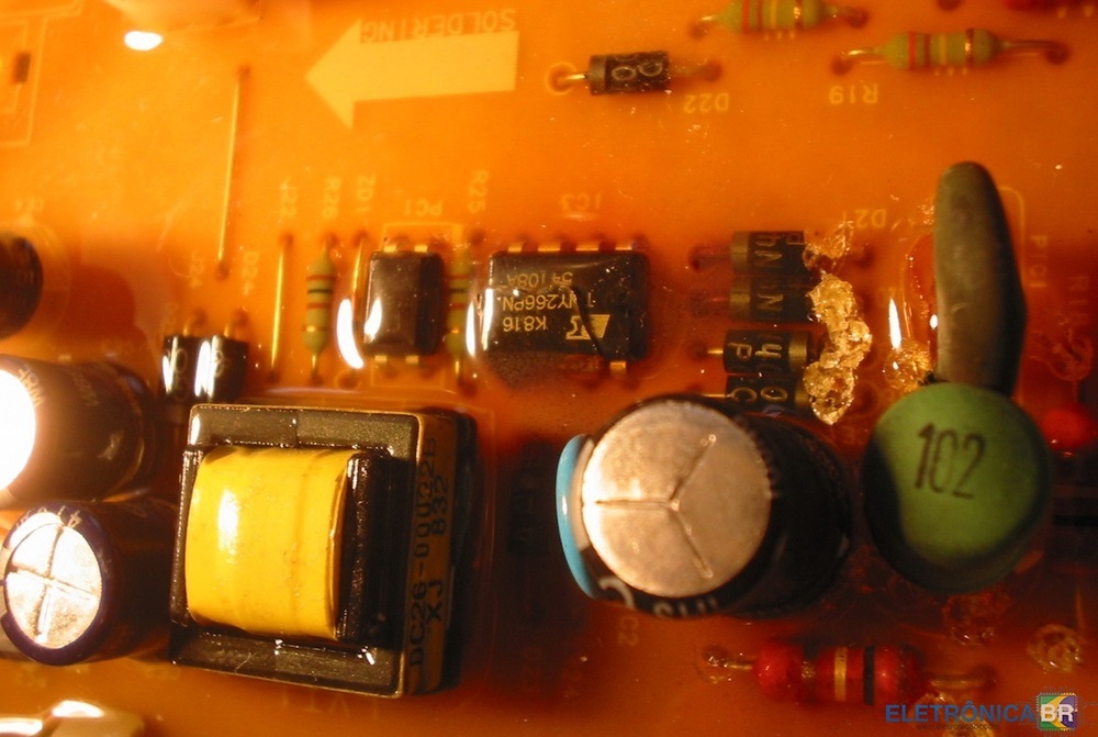

  3. The Made in Korea washing machine has a DTC E8. A plastic window was opened on the back of the plastic molded module housing. The error was already visible. The part of the component has broken out of the solder. Suctioned tin with suction sock. Then soldered with lead containing solder tin. Washing machine repaired.
  4. "The power went out."Nutrition. IC replacement. Power .ELKO's hopesThe first photo shows that the 230Vac is fed through the foot of the heater relay (black crocodile tweezers) and the white one-way connector (red crocodile tweezers) from the DISCONNECT TRAFFIC!
  5. Nutrition. There was smoke coming from IC. "Power IC replacement. (Worth putting in.) 10uF / 450V ELKO replacement
