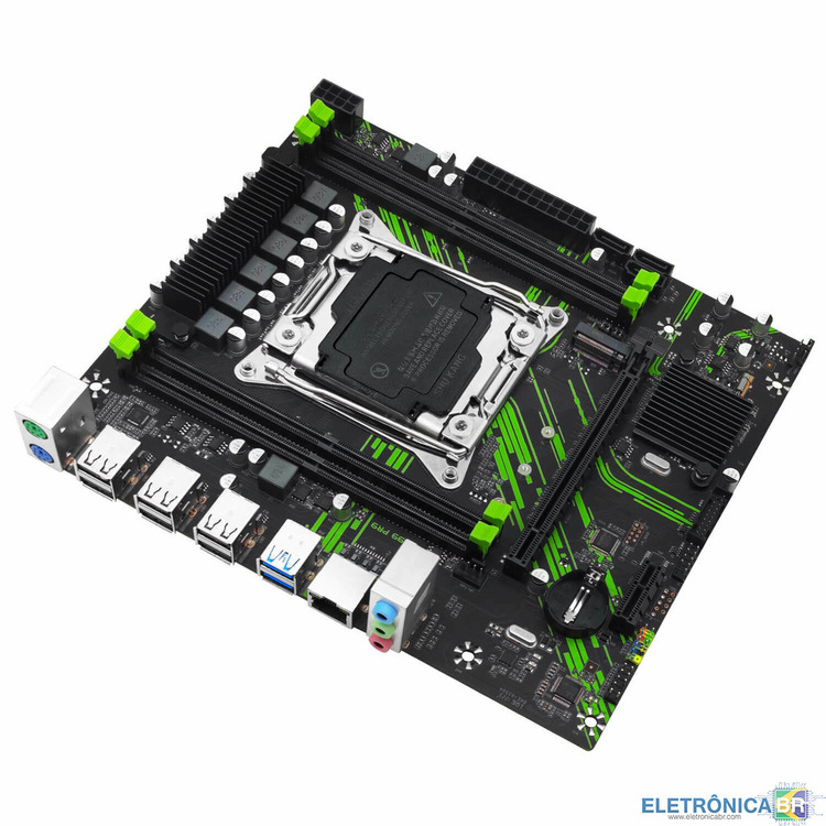

  3. A BIOS DA MUCAI X99 P4 NÃO É A MESMA QUE A DA HUANANZI X99 P4, FUI ATUALIZAR E BRICKOU, ESTOU PROCURANDO A BIOS DA MUCAI X99 P4 AMERICAN MEGATRENDS 5.11 PARA GRAVAR E CONSERTAR O PROBLEMA, SE DER CERTO VOLTO PARA AVISAR
