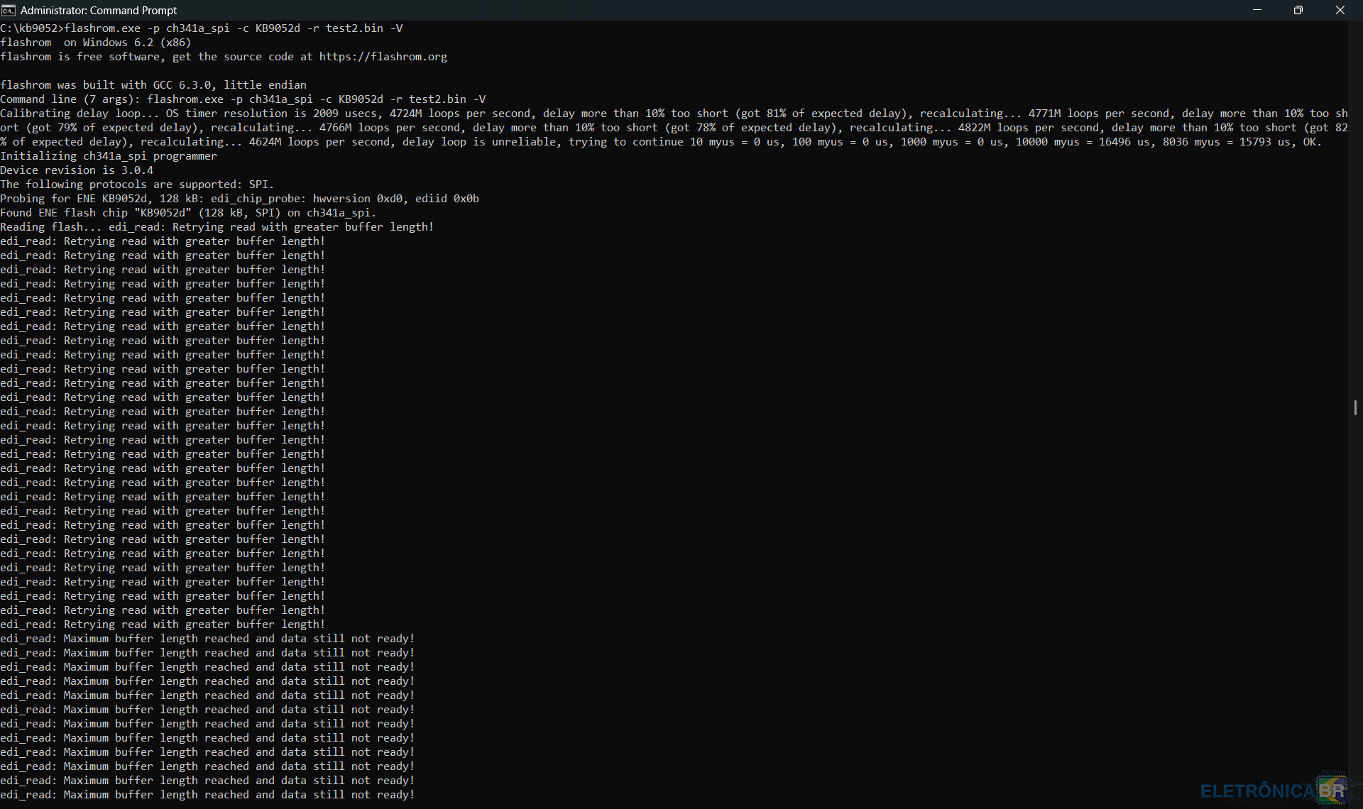

Hello,
Good Morning,
I need your help, I don't know what is wrong.
I am keep getting this error when trying to read the KB9052QD.
I have got your Flashrom from this website by paying subscription before.
These are mostly in loop if i run command again and again.
My Mobo is GH51G LA-L181P REV 1C with KB9052QD
My pin Layout is like this
Pin ------- Keyboard Connector# -------- CH341A
Ksi4 ------------ 6 ------------------------- CS (1)
Ksi5 ------------ 5 ------------------------- CLK (6)
Ksi6 ------------ 4 ------------------------- MOSI (5)
Ksi7 ------------ 3 ------------------------- MIOS (2)
Kso3 ------------ 23 ------------------------- GND + Laptop GND
For More assurance I solder a wire from ENE KB9052 Pin 43 (KSO3) ----> Laptop GND
All connections are verified and working.
20260531_061809.jpg.jpeg20260531_061817.jpg.jpeg20260531_061847.jpg.jpeg20260531_061943.jpg.jpeg20260531_062138.jpg.jpeg
Ribbon cable is 5cm and the wires from FPC board to CH341A is less then 3cm
The Problem, I attached the Egpu to my laptop via M.2 it was working fine. ChatGPT said i have to enable IMR configuration in advanced bios and set to SA PCIe and increase the aperture size to 1024 mb to get the best performance. i did save the setting but then my laptop just keyboard lights coming on and no display or anything. i tried CMOS and Crisis recovery but nothing worked. then i searched and bought ch341a programmer device and made bios backups and got cleaned bios from other community for ACER Nitro 5 AN515-57 to reset my bios to default and i flashed the new file. now the keyboard lights are also not coming on. just the power led turn on for few sec then turns off. no fan, no life, nothing. they also gave EC.bin so i'm trying to make flash it but not working.
Please guide what should i do?
What i am doing wrong?
please help,
Hope to hear from you soon.

  • Autor
@Mubashir Ahmad
Hi,
It looks like you are having communication issues. Usually, I use — and recommend that you use as well — a very short ATA80 cable to connect the board to the CH341A.
In the past, I used a jig similar to yours and it worked fine. However, after some time and after switching to a newer version of the CH341A programmer, I started getting communication errors. I solved the problem by using a short ATA80 cable instead.
Also, on your jig, some traces are shorter than others. It is very important to keep all communication wires at exactly the same length. For the ground connection, I always use two wires from the ATA80 cable.
Another point is that the wires below your jig may cause interference because they are not properly arranged for high-speed communication. Even my old jig used parallel wires with equal lengths. In your case, the wiring looks more like spaghetti wiring. For 8 MHz communication, signal integrity becomes very sensitive, and this kind of wiring can easily cause communication errors.
Looking at the photos, I can also see that some signal wires follow significantly different paths and lengths after leaving the adapter board. Keeping CLK, MOSI, MISO and CS as equal as possible in length often improves reliability.
Communication problems can also occur if the EC is not receiving 3.3V power or if the EC itself is defective.
Please verify that 3.3V is present on the EC while the charger is connected. Flashrom will not be able to communicate properly if the EC is not powered.
I don't know exactly which version of flashrom you are using, but recent versions have two IDs for the KB9052: KB9052B and KB9052D. Neither of them includes "(EDI)" in the name.
Since you already paid for VIP access in the past and apparently downloaded an older version of flashrom, I will give your post a 👍. Then go to the Signatures panel on the site, enter "free download", and select "Download 1". After that, you will be able to download the latest version of flashrom.
After you have verified that 3.3V is present on the EC, improved the connection between the board and the CH341A, and downloaded the last flashrom version, please follow the procedure below:
  1. Connect the wires between the board and the CH341A.
  2. Connect the CH341A to the USB cable.
  3. Connect the laptop charger.
  4. Press Enter in the Command Prompt window where the flashrom command is already typed and waiting to be executed.
Please use Command Prompt (CMD) instead of PowerShell, and run it as Administrator just to eliminate that possibility.
I have never tested flashrom under Windows 11, so I cannot confirm whether the driver works properly there. If you are using Windows 11, please try Windows 10 as well.
Good luck, and let us know the results.
Editado: por Jack O'Neo
adição de conteúdo.

@Jack O'Neo Thank you so much, It worked once but after that it making issue again. which i don't understand at all.
I used the cables of ch341a Bios Flashing clip all cable length are the same and under 2.5CM after FFC board.
Here you can see,
and it worked I was able to read and write once. here is the image of writing.
but after flashing i flash the bios and other things the laptop didn't work so i try to read and verify the ec firmware again weather is good or not and tried writing the new one but i am keep getting "edi_read: maximum buffer length reached and data still not ready!"
it is detecting the chip every single time and read it for few sec and then it start writing these lines in CMD continues and not stop also the read/write light on ch341a also stays on. Even i manually aboard the operation by pressing Ctrl+C. Here you can see,
I don't know what's going on and what i am doing wrong. I have resoldered all the joints again. i have measure all the connection in resistance mode. all of them are 0.8 (My Multimeter Probe have 0.6 by default.)
I spoke with Cluade and Gemini and tried multiple things like -N with command and --force with command, but no success at the end they says it could be 8051 something. and i should ask you because you are the developer and have way more experience in it.
Can you please guide what should i do.
Kind regards.

  • Autor
@Mubashir Ahmad Hi, sorry for the delay in responding.
Man, I still believe that your problem comes from the connections between the programmer and the board.
The programmer is looking for the chip and finds it. When communication starts, however, it could be receiving trash data. This could be caused by the wires, for example. The jig board could also act as an antenna and pick up interference from your Wi-Fi.
This could be the reason why the laptop did not start working again after flashing it. If the communication did not occur as expected, it may have flashed something different from what you sent.
Just to clarify, I'm not developer of Flashrom. I only added support for some ENE chips and provided a driver that allows it to be used with the CH341A on Windows. Anyway, It looks like all these EC from ENE, are based in the old 8051.
You should trust me on the IDE 80 vias cable, it worked like a charm to all people who tried it. ;D
I wish you good luck, and wish too that I could have better news.
Kind regards.
