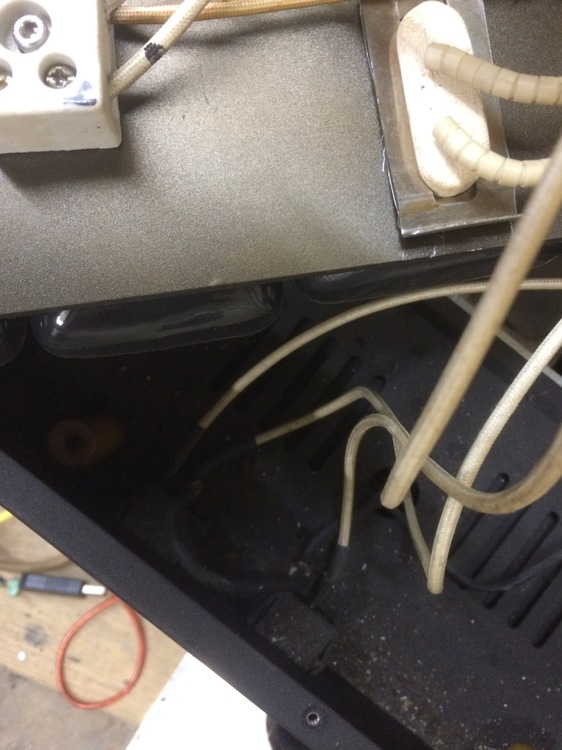

2 minutes ago, Paulo Noce said:
@sasserworm11 sasser
See answer # 63 and make the setup.
Yes i do. But still no luck. I see the first startup tc read 200c its correct? And do u hav the picture about tc connection? Maybe mine is incorrect refer attachment
