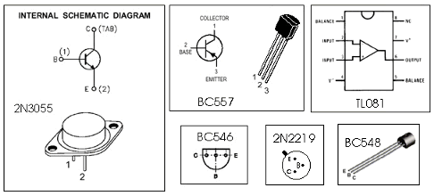

Q1 = BC548, NPN transistor ou BC547
Q2 = 2N2219 NPN transistor
Q3 = BC557, PNP transistor ou BC327
Q4 = 2N3055 NPN transistor de potência
U1, U2, U3 = TL081, amplificador operacional
